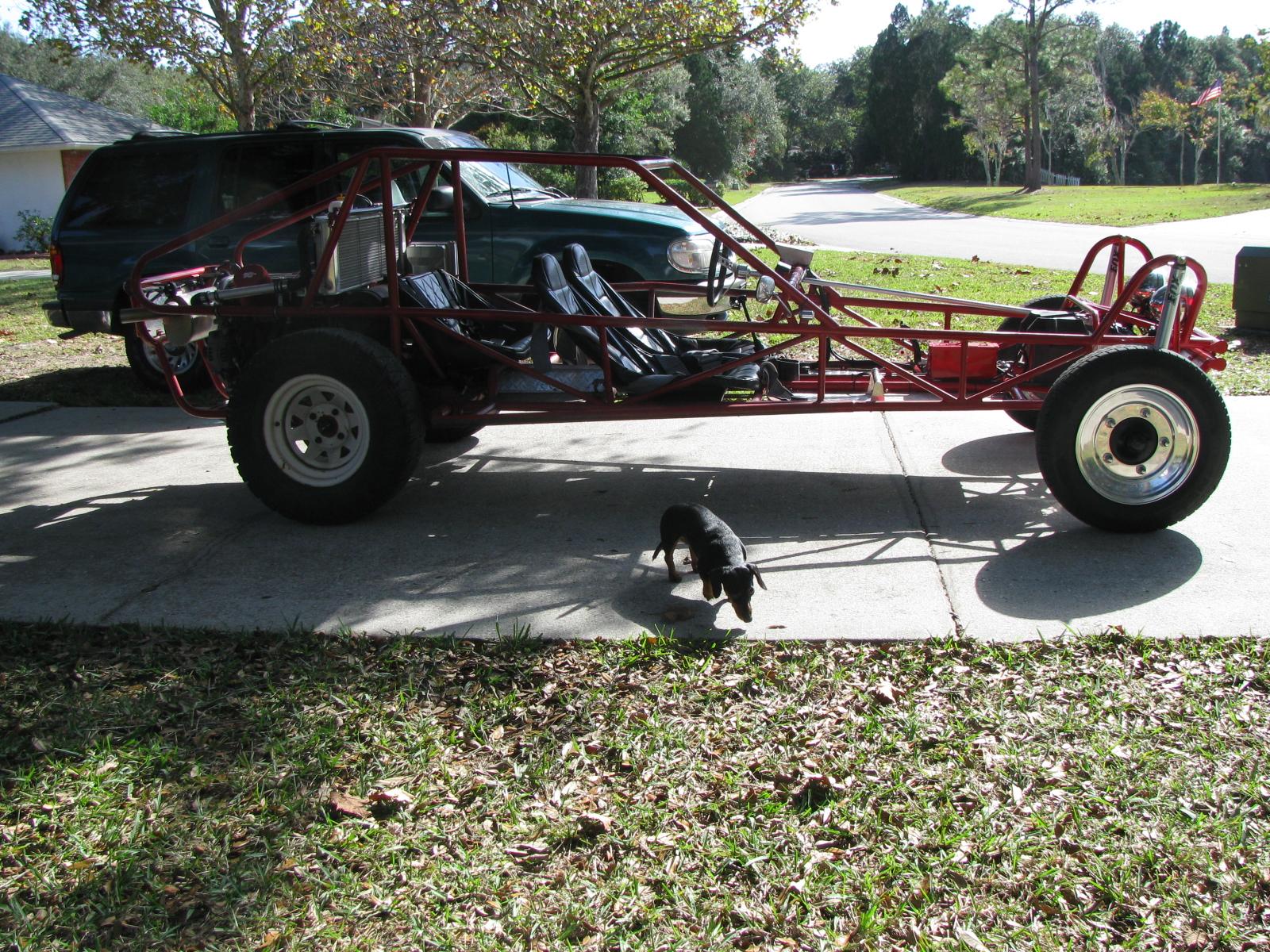

Thanks for the info Lee. It does look like I will be doing quite a bit of research. Here's a picture of my rail. I'd like to start doing more trail running instead of sand I'm trying to figure out the best process

Here you go Lee. Looking to convert it to more of a trail than a sand buggy

It looks to be a 4-seater long back style of buggy. It is set up for the sand with the front tires being tractor tires and the rear tires being Sport Tracs which I run on my glass buggy. The MFG. recommends the tire pressure set at 5# and they do work best at that pressure. I am not sure if they are street legal or not and I don't remember who makes them right now.
You have a K&L style AL front beam with conventional VW steering. The beam "looks" to be laid back for a lot of caster which is fairly desirable on the sand. I can't tell for sure if you have IRS or swing axle in the rear but the tire does look to be sitting straight up so a rough guess would be IRS (guessing is a risk to the guesser ). The fuel tank is located normally, The rear shock look to be gas shocks as I think I see a reservoir.
A grab bar for the passenger, older seats (but comfortable looking), the dash looks to be fairly normal, a cover over your head, the lighting should be OK for off-road but for the street you'd have to check state and fed height limits (as I remember, 20" and 53" are the two limits in the state I live in) but no rear view mirrors (tisk, tisk )
If you are going to make it street legal then some work is needed. I think I would add front brakes also if you are going to trail ride it. A mechanical E-brake would be a good addition and I might look into some gussets on the cage connections to the frame.
Over all it looks like a pretty darn good start for an off-road rig.

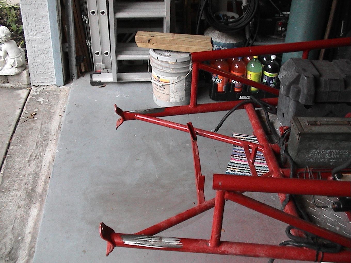

That buggy is not mine, I have glass bodied buggies like a Manx or a Mini T +4. That rail is owned by a guy I know; the pictures were taken at different re-build stages of the rail (a constant thing if you allow it and want to be current ).
This slide is compliments of Dustymohave; he is very into off-road racing and this is his recommendation of splicing in/joining tubing and having a strong, worthwhile seam in the process. I have a lot of respect for his knowledge!

Yes, if you are going to cut your frame to raise it, DO this at ALL joints. You might be able to lower your seats and lay them back at the same time, saving from cutting frame.

Here is mine on a side view.

Hi JRam,
It does look like you have a lot more head room than mine.
From the side of yours, Maybe thinking about adding a few more bars to help in a roll over.
I have rolled mine once and did some front end damage. Cut it off and rebuild.
You never plan on a rolling it but I glad that the roof area was strong.
