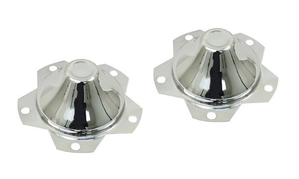

What are those centercaps? They look great, fantastic ride man.

Chris V wrote:What are those centercaps? They look great, fantastic ride man.
Thank you. The center caps are aluminum ones I got at Pacific Customs. They are similar to these, just not as deep.

Good eye on the center caps Chris, I didn't notice those, or even know they existed... They look a little cleaner than those stamped chromed china tins.
