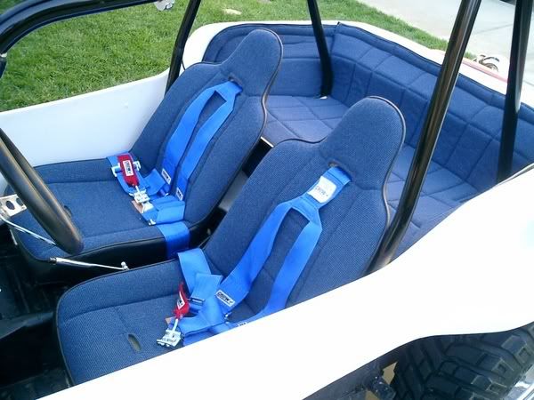

I set in the seats and the new front end. Stock with adjusters. all new..

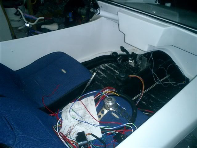

Pulled body to do wires. pan was also rhino lined.

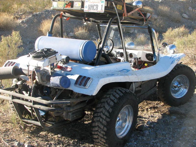

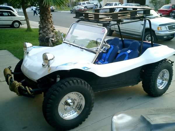

I added a roof rack and some cheep lights.

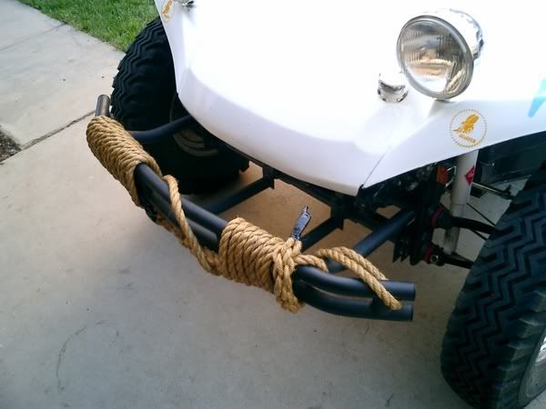

Here is a few items I like to be on my cars.
note the shovel.
Rope and hooks

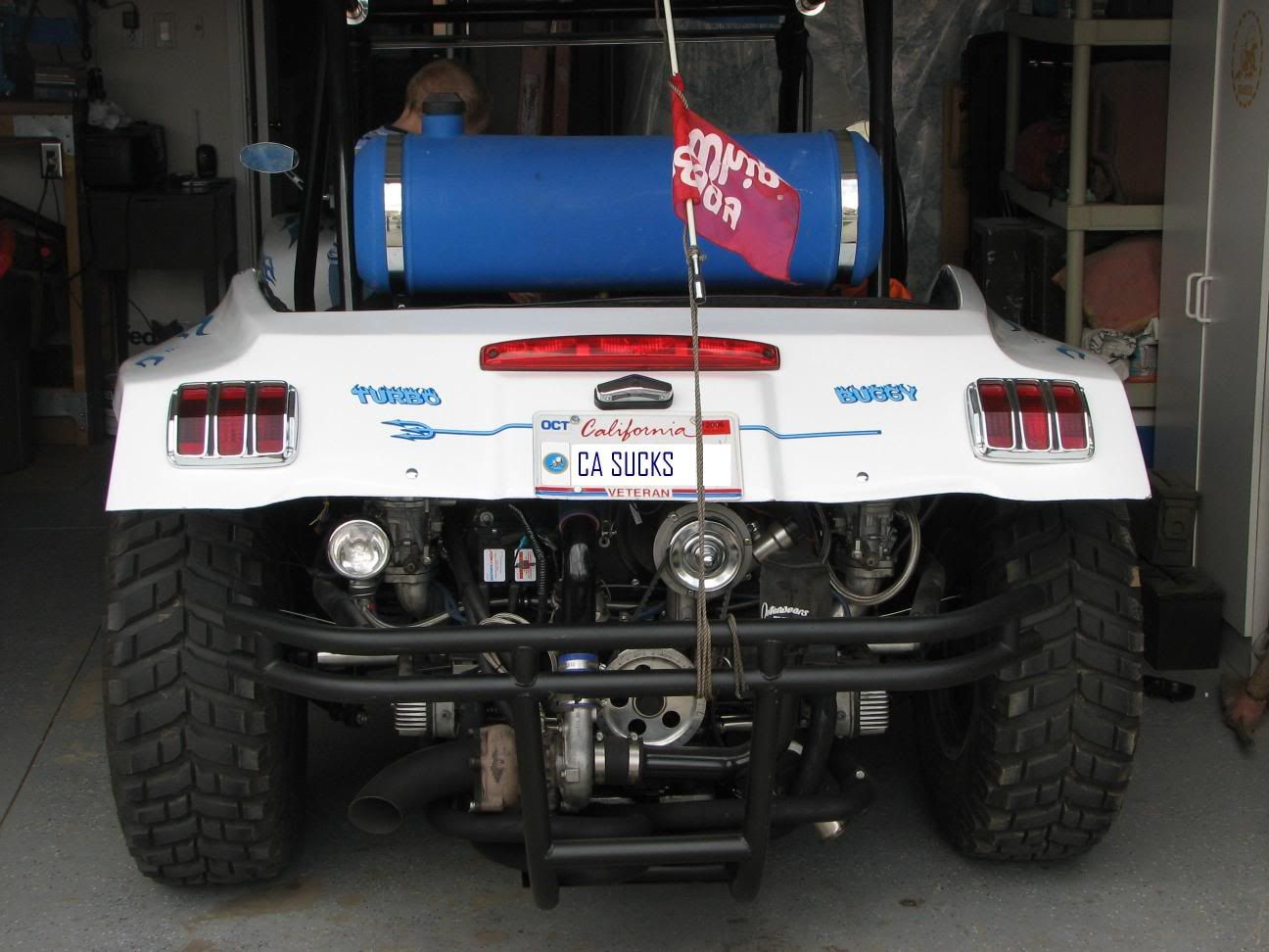

this was a great clean look but i lost almost 4'' of ground clearance due to turbo header. So i changed everything .
new CB header Much better power and clearance.

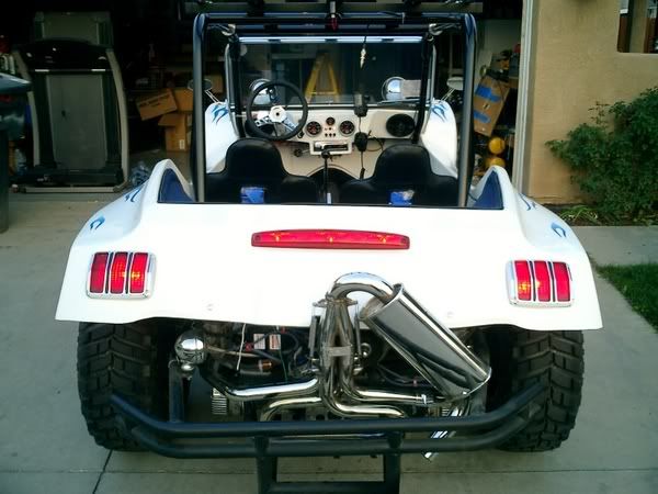

The pipe was too loud so a change was in order, also note the new fuel tank, I have 2 tanks and a switch to change them.

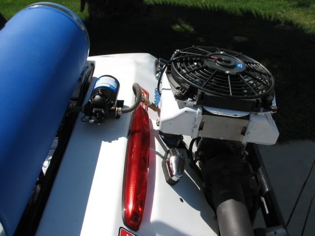

I smoked that engine quick so i needed to change a few things. new Pistons and rings. LM1 for tuning I added a ugly inter cooler for 7$
I also added Alki injection This was the best place to put it . Cant see it from behind the ugly Inter cooler.

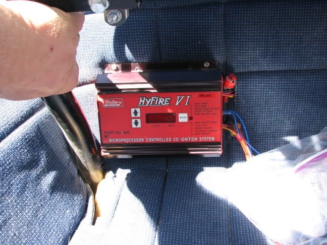

I also added a new mallory system to help keep my new 3rd engine from going up in smoke.

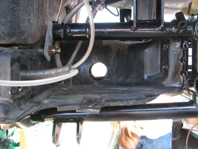

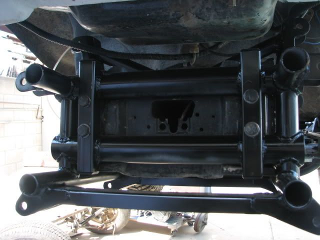

New IRS and 3x3 930 going in also shocks 28mm bars and more cage gong in.
bump stops.
New 3x3's looking great.

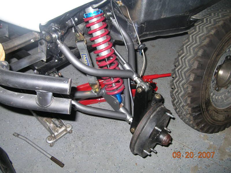

Well I cant keep the Stock Front end. So I called on Pete at A-ARM.COM
He worked his magic on a new design for king link front ends.
The unit bolts right on
Here is where the Rack & P go. Right in the tunnel for no bump .
Technical help was the best. :)
Now we are talking.
Still no brakes and need to go back to shop to complete cage, and put hanging pedals in.
Inside cage and pedals done.
Painted the arms.
Also added side bars with Alum diamond plate
Note: My 4yo in Photo is over 4' tall. The car now has 20.5'' ground clearance.
I added 2 more lights. and a 105 amp alt.

looking real good there, i need to put a shovel mount on mine. and I really like the rope on the bumper look, gotta try something like that on mine.

Thank you guys. It has been a money pit ----- I mean fun. :shock: Some day I hope to do something with in cooler. Add a larger one up higher or in a small wing in the rear. I really like the lights I have on the car. The large 3rd brake light off a dodge truck. I found the inter cooler on e bay, it is a rx7 . I see them there once in a while. The custom aluminum cover the directs the air from the fan cost more then the cooler and the fan. hand made polished up. Silly me. Next time it is steel and spray paint. :lol:

I have the Fox 2.0 7/8'' shaft 6.5'' travel shock. 250 lb spring . I get 13'' travel it can get more but I have yet to bottom it out on whoops doing 60mph on hard and sand whoops.
