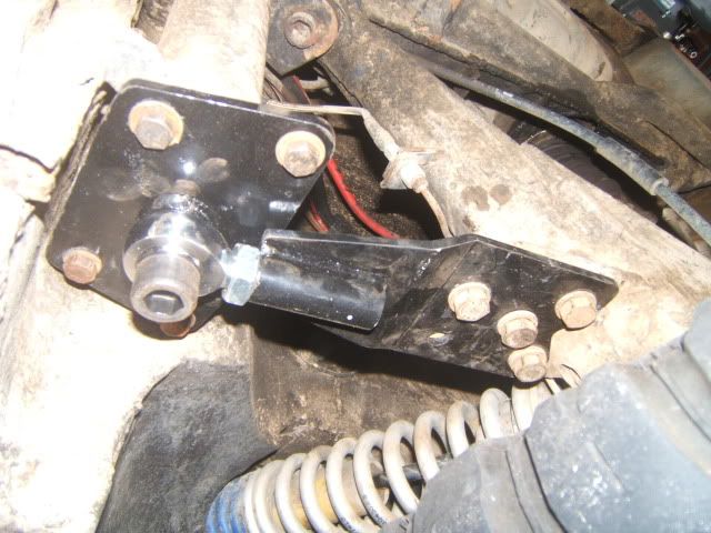

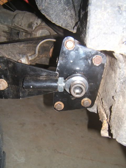

I finally got some time to get stuck into this thing, have parts just lying around is such a tease! The coil over conversion plates from eagle are quality and with a little bit of fiddling bolt straight on, and as hoped make adjusting the rear toe a breeze.
That done, moving to the front.

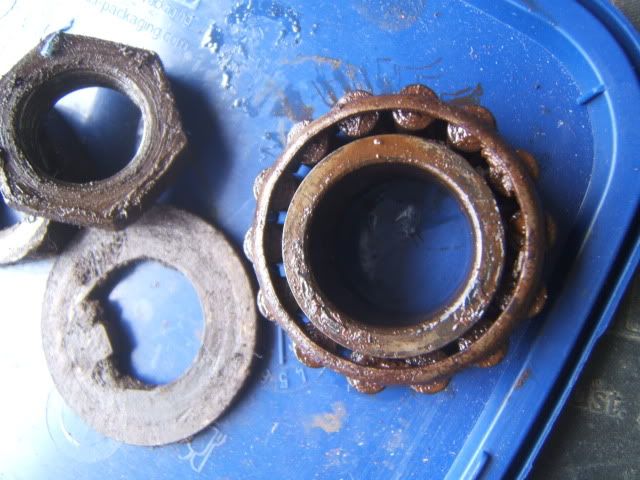

Until then i have bigger problems, I had some play in the steering that I feel was getting worse (am I right in saying many of us have had that feeling?) I started on the out side with the hubs and found the speedo side had some play, as it turns out taken a glup of water and was chewing the bearings. I think its time to fill the hole and turn to GPS for speed indication, I always did hate replacing or repacking that bearing three times as often as the other.

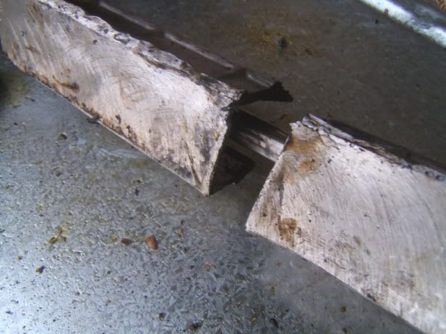

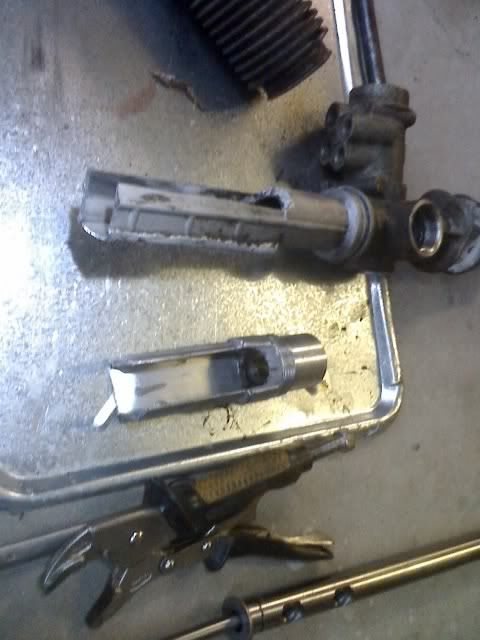

Will decide during the week wether I add a disc brake kit to new bearings, but as i worked over the rest of the steering to find the play I noticed that one end of the rack was not sitting in its saddle correctly. Turns out Daewoo parts where not ment to baja :lol:
Nice clean brake huh?
Crazy as this may seem, I am not looking as this a a great problem. Will take it to work, have one of the welders put it back together, brace it while his at it and then heat treat the body. ready for round two. That or I will make a whole new body for it out of billet, will see what those with more knowledge that i have to say on monday
