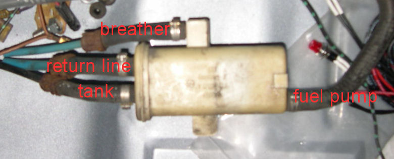

But I am thinking about replacing my home made "merge pipe" (the 22 mm pipe with the inlet, return and outlet on it) , with this factory VW "cachetank":
It's meant for some VW Golf convertibles that were equiped with a fuel injection system.
See:
It's actually a small swirl pot. In the Golf a small in-tank pump delivers fuel into it. One hose attached to
it will be the return fuel line that comes from the engine. The fuel hose on top will provide a fuel return
hose to the tank, for the small fuel pump. And there is this larger outlet that goes to the main fuel
injection pump.
I think this is an ideal and cheap alternative for a swirl tank. They sell for about 20 euros (listed
wrongly as "fuel filter", btw). The VW part number is: 533201511A .
Once I got my other projects done, I am going to use one of these for my beetle.
This is how I would connect it:
The great thing is, that this thing offers a way to convert your beetle/bus to fuel injection without
having to modify the fuel tank!
And you don't have to worry about running out of fuel in a corner.
The only drawback I can think of is the fuel heating up, but as my fuel lines run under the car all the way
to the back and back to the front again, I think the fuel will get enough cooling. It never was an issue with my
current setup.
Apparently, the black hose is 6 mm (would be perfect for a VW beetle tank outlet), the blue hoses are 8 mm,
and the fuel pump outlet is 10.22 mm.
I found this thing in this german thread: LINK
So, anybody ever tried to use this thing?

Hi, I know this is a very old topic but would like to ask some advice from the guys with more expierience. I installed a Y piece and filter for the accumilator but now my fuel pressure is up by about 7-8 psi and I can hear the pump taking strain. Does this mean I need a bigger filter / accumilator? Or where should I start looking? What volume should I look for in thd filter?
Thanks

Hi Ray, I installed the Y with the tank feed and return on the top legs and the bottom leg to the filter and then to the pump. I tried to get the filter mentioned on the thread but it seems the part numbers are different or non existent on my side of the world. VW also didnt have the models mentioned for the filter to use locally. The filter I used the biggest low pressure filter they had and I would estimate it around 2" diameter by 2" long.

Yes...that filter is small. The filter they used for Mk-1 cabrio that Piledriver noted....is a large low pressure filter. It should be similar for any digifant II engined car. Ray

The accumulator allows the pump some volume to feed from. Many fuel pumps do not "suck" well. A great many pumps are fed by a moderate volume/very low pressure feeder pump. Others are put at the lowest point below the tank so that gravity wil force feed at a very low pressure. It keeps the pump from cavitating.
The problem with jsut gravity is feed is that on fuel tanks that do not have surge rings built in for fuel injection, teh naturalsloshing f rom driving, having a half tank ro less or from cornering can cause interuptions in gravity feed. The accumulator helps prevent this. Ray
