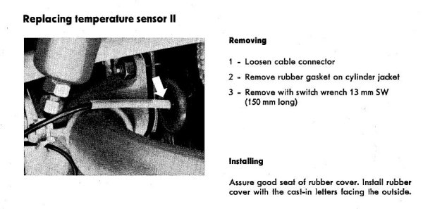

I dont think it is neccesary to remove the manifold or injectors, the sensor is slightly in front of it and (I think) angled a bit forward. A slotted or deep 13mm socket so the wire has somewhere to go is required.
This is what the 411 workshop manual says:

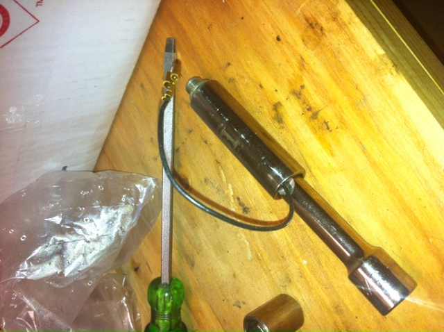

Some people make special tools, this is from a Porsche 914 site (same Engine but the wire on this one seems extreeeemely long):

Thanks! Maybe I'm not holding my face "just right" when I tried to get at it with my socket. I will try again. I used a drill press to drill a hole in the side of my socket to make the job easier. I will give this another shot and report back.

Well, I'm here to report that this issue here was me! I have a 1/2" drive deep 13mm socket. Well, that was the reason I was having issues. It works fine on the Beetle, but not so much on a Type 4. I tried to get at it with a 3/8 drive 13mm deep socket and it gets it. I will mod this socket and see how the job goes. If I screw it up, well, I will do what Wildthings shows and tap a different area.

The other socket I used a drill press to modify worked wonderfully, combined with extensions that allow about 15 degrees of sideway movement. This socket is now in my VW specific toolbox along with other VW tools and the Torquemeister.
