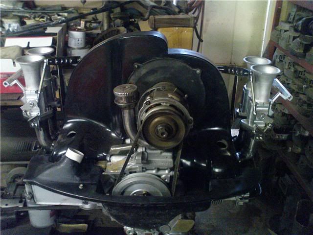

Check it out:jinx wrote:any links?blitzvw wrote:There is also the IMPI shroud from South Africa
http://www.aircooledvwsa.co.za/viewtopic.php?f=6&t=30
http://www.youtube.com/watch?v=RM3C_Q9j_MY
Say hello to us on AircooledVWSA. You can also reach IMPI there and ask him about the shroud

SIMPLE! on THAT motor, a CJ or CU closed breather model, it looks like they took a piece of 1.5inch U-bend tubing, drilleded a hole for the breather pipe to fit through, then strapped everything down to the middle case bolt with a T1 alt strap.MRRAGPICKER wrote:I'd like to see more pictures of how they go about mounting the alternator.
Look closely, no dizzy......
